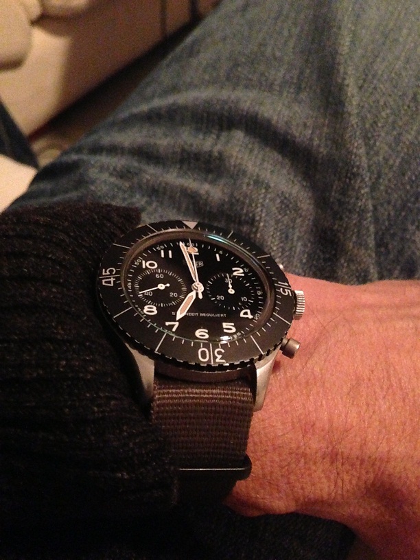

: Thanks for the thread Jeff - I wasn't going to post anything for
: another week or two as I'm cameraless, so I only have the
: telephone, but here goes...
: I've always liked this family, right from the early Leonidas,
: through the standard Bunds and on to the Tutimas of more recent
: times. In amongst this large family there are the oddities of
: course, the Heuer Cal 12 prototype Bund that never was is
: probably the rarest of them. Next up is probably this variant of
: the standard Heuer 1550 Bund, it is the Sternzeit Reguliert
: version, the 1551 SGSZ, issued to artillery units in the early
: seventies as an astro-navigational chronometer. It originally
: came in a leather case with a star chart and notes, but I don't
: have that at the moment.
: 'Sternzeit Reguliert' translates as 'Regulated to Sidereal time'
: which runs about 4 minutes a day slower than local time. This
: was to assist in theodolite sighted position-fixing by the
: artillery units (it's important to know where you are so you
: know how to far and in what direction to lob your shells).
: Mine has been regulated to run at a normal rate; 18,000bph in the
: case of the Valjoux 230 movement that runs it. The movement
: itself is a good one, based on the Valjoux 23, manual of course,
: column wheel and fly-back.

: The unique NSN for the Sternzeits -
: Flush, nicely bevelled crystal:
: Next to the similarly cased Sinn 156:
: And the backs - notice the slightly asymmetric pushers on the
: Valjoux 230 as opposed to the Lemania 5100 and the difference in
: caseback depth between the manual and auotomatic:
: Anyway a brief look at an uncommon variant on the Bunds, I guess
: about 100-150, possibly more, but you don't see them for sale
: very often. Some of them changed dials at service, but the NSN
: and 1551 SGSZ engraving between the lugs are unique to this
: model.
