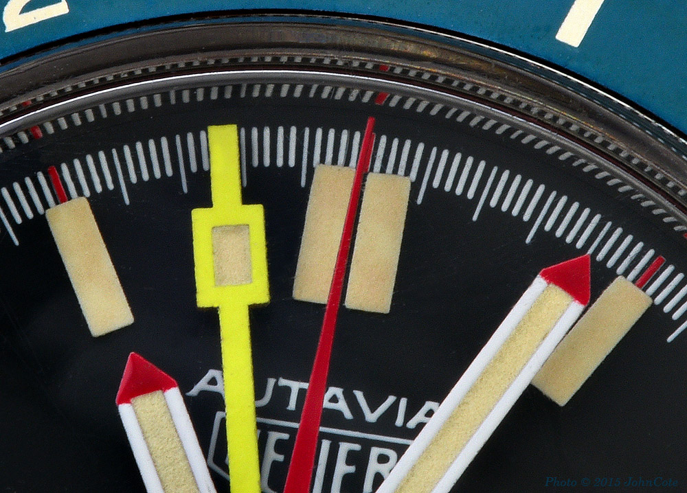

Thanks so much for sharing your secrets!! So many of us benefit from the amazing information shared here!!
Can you tell us about the lights used for this photo? Hot / cold; always-on / strobe?
Thanks,

: reality. Jeff S has displayed a couple of really nice photos in
: the past couple of days. The two that stick out in my mind were
: the red hand tip of his new GMT and the above lume pic. These

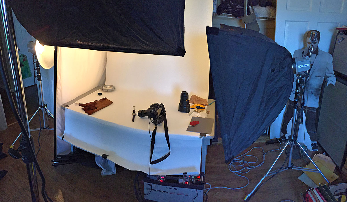

: photos put a picture in my mind. I knew I could not take the
: picture with my iPhone and luckily my lights were home from the
: studio over at IndyCar and set up for small objects. I put an
: old manual focus 200mm Micro Nikkor on my Nikon D810 and
: focused. The setup is pictured below. Elvis watching over the
: scene helped a lot. There was also about 15-20 minutes of
: PhotoShop work involved in making the file from the camera look
: like the image in my head.
