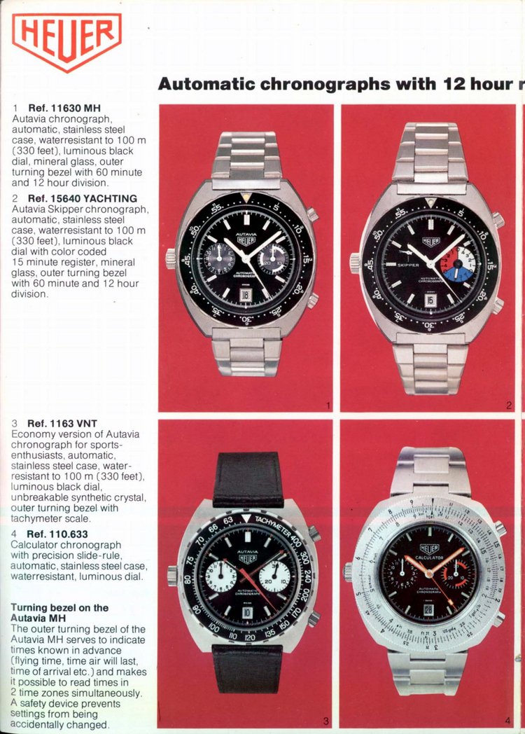

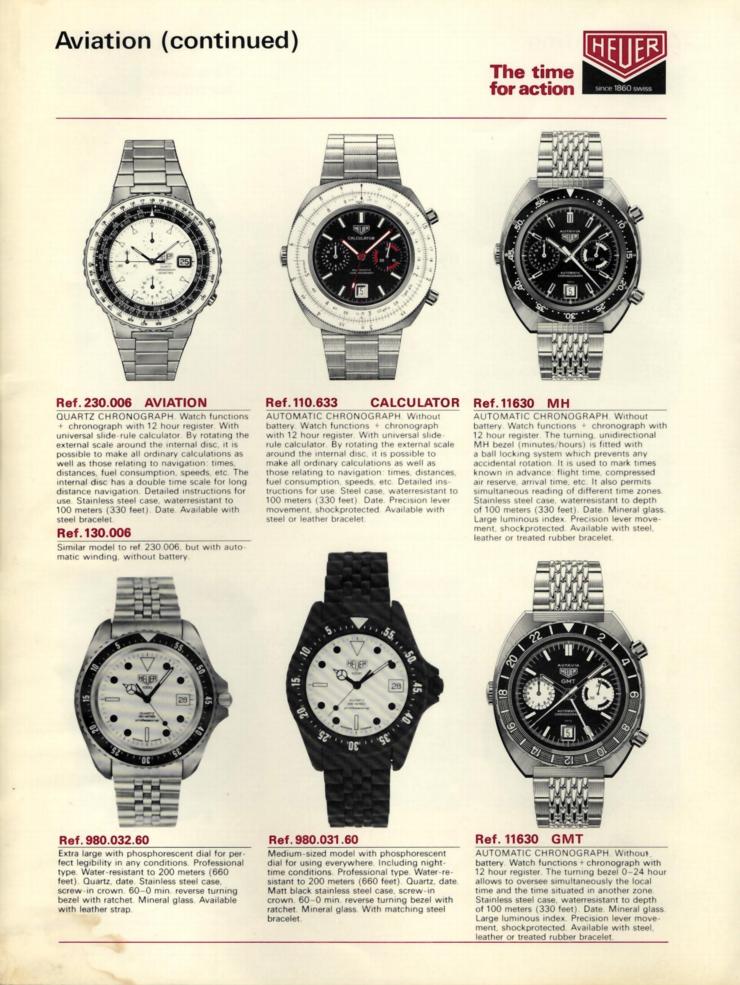

I have created a page (or two) for these pilots chronographs, but have a couple of questions:
  • what year were they introduced? I see them in 1980 catalog, but wonder whether they were introduced earlier.
    Jeff,
    Ê
    The earliest incidence of this type of chronograph is in the 1980 timeframe. I have posted nearly everything I have in the late 1970's timeframe, and have mainly the early 1980's and the TAG-Heuer stuff in front of me to scan... As those books are over 100 pages a piece... Well... I need to really psych myself up for the task of scanning them...
    However, this configuration of the 230.006 with a white outer bezel is one I've never seen in the flesh Àsteel?. Basically, there are two dial colors (Black/Silver), two movement types (Quartz/Automatic), two brands (Heuer/TAG-Heuer versions). A total of (2 x 2 x 2 =) 8 different combinations in this lline.
  • Heuer seems to call them "Aviation" chronographs in the catalogs. Are we OK with that name? The more common reference among the enthusiasts seems to be to "Pilots" chronographs. What'll it be?
Avaition is what they call them in the 1980 catalog. However the dial they are noted as "Pilots" and in the later catalogs they are called "Quartz Chronographs Pilot" (with notation of the Automatic version)...
Your choice... I don't think we call the Ref. 15640 YACHTING the "YACHTING"... We call it a Skipper... Or at least I do. But you make the call...
