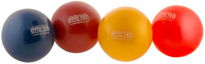

There is also a ball that is squished against the back of the watch and twisted to open the case (the ball basically acts to increase friction a thousand fold). I never used one, but it seems like a pretty good idea (no scratches from this device).
HORB "Screw Ball"
www.ofrei.com: $8.95
Boston Watch Exchange: $12.95

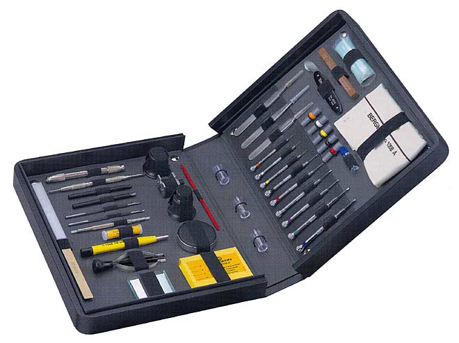

If you're planning to open the back and "investigate" I suggest getting the watch kits because you're not likely going to have 0.8mm, 1.0mm and 1.2mm flatheads laying around. I started a Watch Project awhile ago and I'll say that if you want to keep using the tools invest in high quality Bergeon tools; they're well worth the money (my favorite "drivers" are the Bergeon 6899 screwdrivers, these can be bought as a set for a little over $200 or can be purchased individually for $9.95 at http://www.ofrei.com/page1205.html).
The BEST (but certainly not cheap) drivers on the market.
www.ofrei.com: $230
Boston Watch Exchange: $360
Lancaster Horological Supply: N/A, but they do have the old Bergeon 5970 set for $67
Bergeon 5970; Bergeon's most popular and 3rd best set.
If you decide to buy good quality tools on eBay, look for tools at http://stores.ebay.com/Lancaster-Horological-Supply. These guys (by far) offer the best prices in Bergeon Tools. Whatever you do, NEVER buy from the BOSTON WATCH EXCHANGE. Hey, even though I haven't bought anything from them, their prices are WAY TOO high (consistently 33% to 200% overpriced as you can see in the above Bergeon 6899 case!). I only mention these guys because they have a huge amount of the results that pop up on eBay when you search "Bergeon". If you can't find the tool you want at Lancaster Horological Supply (the cheapest Bergeon supplier that I have found) go to www.ofrei.com (these guys sell at the next best prices around).

My "dream" watch kit (with Bergeon 6899 drivers substituting the 5970s)!
