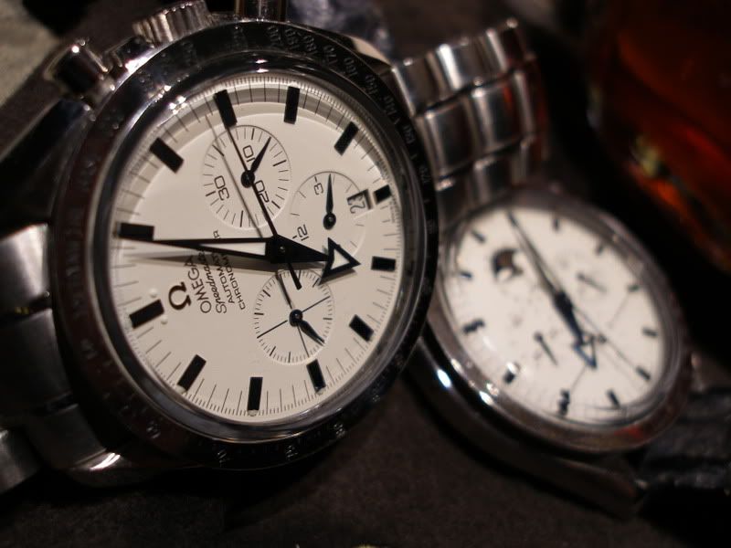

: The same watch failed again within a month with a reset problem. I
: also have a Broad Arrow that had a
: reset problem with the pushers and again with the minute
: totalizator. Both watches were repaired by
: the Omega Service Center in Atlanta and I have had no more problems
: after the fix kit issued by Omega
: was installed. I will add that both were early models and the kits
: were not installed at the factory, the newer
: models are more reliable. The Chrono reset arms are fitted with
: stronger pieces that don't deflect under pressure
: and the stems have been changed. They give little trouble in
: current models. I had Chuck Maddox to thank

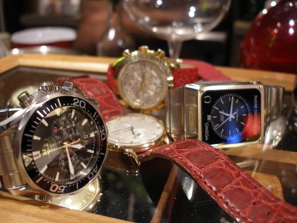

: for uncovering the problems with these movements. I also have a
: Seamaster Chrono with a 33XX that has been
: trouble free and runs perfectly. After all the problems I still

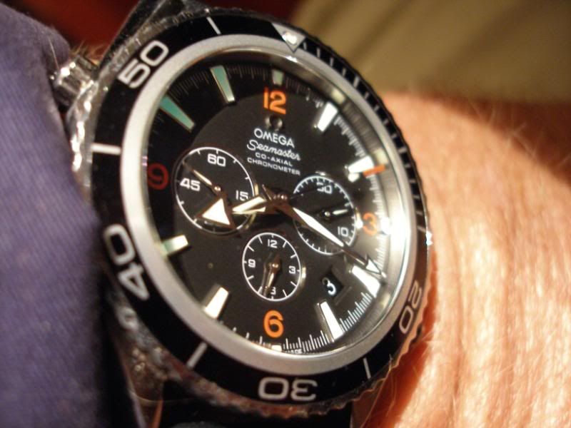

As I said, 'thanks' for the info and great pics. The model I'm looking at is brand new so any of the problems of the earlier models should be corrected.
