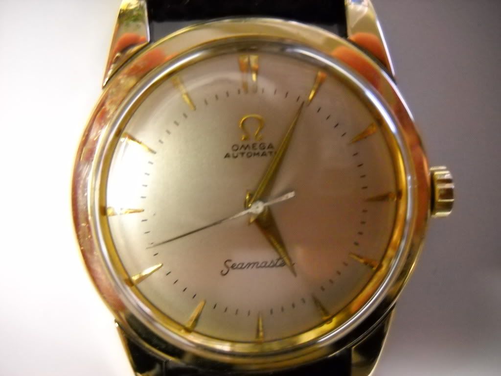

: Just wondering if anybody can identify date/model of this
: particular watch. I appreciate all your responses. I have more
: photos of the watch as well. There are no serial numbers and/or
: seahorse insignia on back of watch. Thanks
The identification of the watch is easier if the watch can be opened.
The inside of the case back will have a number in the form 1111 or 11111. This will be the case/model number.
The movement of the watch will have two numbers. One will be three digits (111) near a horseshoe shape (the Greek letter Omega). This is the calibre number.
The movement will also have an 8 digit number (11111111) which will be the movement serial number. This number will give you a reasonably accurate estimate of the age of the watch.
If you can provide these numbers, we can tell you much more.
By appearance, the watch is from the late 1950s. From the case style, I would guess the caseback is screwed down.
