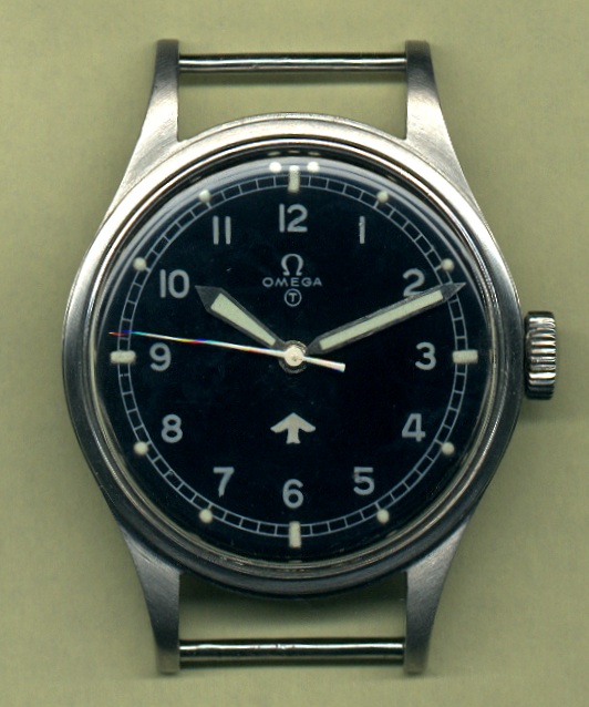

I am a lucky owner of Omega 1953 watches. These watches were produced by Omega in 1952 and delivered to the Royal Air Force in 1953.
The watch has a steel case with 38mm diameter. It is made of "Acier Staybrite" and has the reference number CK-2777.
The movement is an Omega Cal. 283. Inside the case there is a special anti-magnetic cage made of soft iron.
Here is a picture of the watch with original dial:

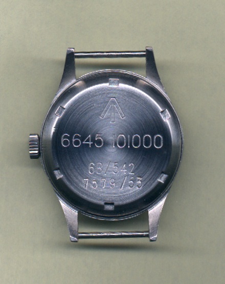

Here is a picture of the case back. It has the typical military engravements:
