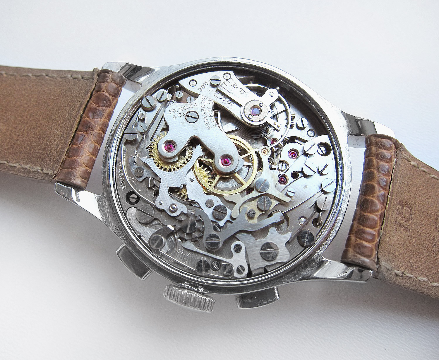

: The small case 'up-down' Heuers bother me the most. I'm not
: categorically saying they aren't original, without any proof.
: But.. If I were looking at buying the one listed on ebay, I'd
: have to question a few areas. First, is that the seller has a
: real talent for finding many of these in stunning condition. In
: all my years of looking, they are like hens teeth & have
: years of patina on them. Second, is the signature on the
: movement bridge. IMHO it is totally wrong. The Heuer shield on
: the dial looks too modern. The proven genuine up-down chronos
: that are know to this forum (mine & Jarls) do not have a
: signature on the movement and have the 'squashed' Heuer shield
: with a '2 Heuer 2' mark.
: Chronoaddicts ebay pics..
: Hard one to judge, the seller might just have a knack for finding
: these old jems in amazing condition. My rule for anything from
: this period.. presume it is incorrect until you can find enough
: proof to satisfy yourself that it is the real deal.
: Stewart
