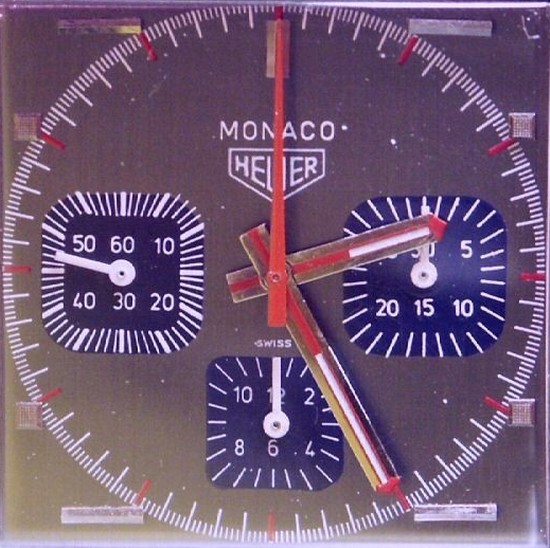

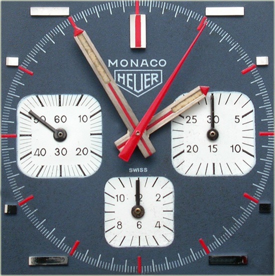

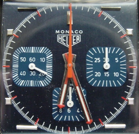

: Now, let's look at some of the disputed dials, including some with
: white dials and waffle markers as well as the blue/blue ones.
: First thing to note is we're not seeing the same sort of
: consistency with the Heuer and Monaco scripts as we do with the
: Singer dials. There are some similarities between them, but not
: the accurate repeatability of a professional printing process.
: It's quite possible that Heuer employed another dial
: manufacturer other than Singer as part of trying to sell these
: at a lower price, but the quality feels too far off - even by
: the late 70s, Heuer would have been in a strong enough position
: to reject them.
: Now, that blue/blue one is better than a lot of them (closed
: 4s etc), but the text does completely lack serifs. That it does,
: and that the three below and Bucherers exist with painted
: markers:
: is, in my opinion, cause for continued questions over Heuer-marked
: blue/blue dials. If Heuer wanted a "cheaper" Monaco to
: sell or get some profit from, it makes sense to me that they
: would make watches for such partners that could be sold more
: cheaply without sullying the Heuer Monaco brand image.
: And that some of the blue/blues with painted markers feature a
: similar shonky Heuer shield to some of the above only adds to
: those concerns:
