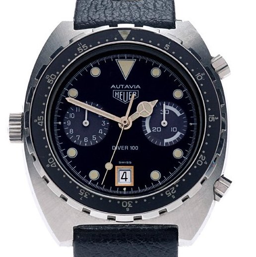

Some late Autavias, such as the aptly named Diver 100 below, made a virtue of increased water resistance but the majority of the models were indeed only water resistant to 30m:
Additionally, I personally believe it's worthwhile treating even a freshly serviced vintage watch as if it has pretty minimal WR. OK for a splash of rain but I wouldn't take it in the shower. Some people do but I take a better safe than sorry line - the service may have replaced gaskets, but will it have done anything about decades of metal on metal contact reducing tolerances? Probably not. A healthy sense of minor paranoia about it might save some expense down the line!
