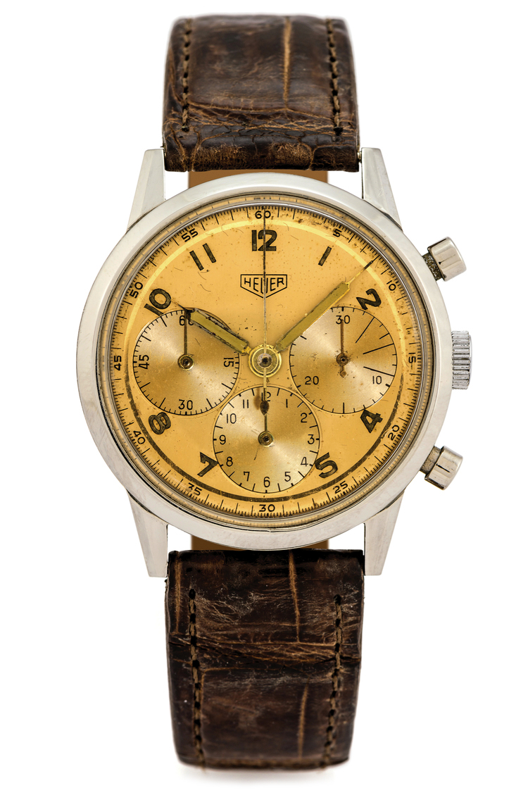

Subject: A ref 2913 auctioned by Antiquorum and as I later found, positively discussed on Hodinkee. The "radial" configuration of Arabic numbers on a Heuer dial is highly unusual (The only one I found is the small 5408 ATT in 1945) The 11 doesn't properly align, the font on the sub registers... I doubt this is a factory dial.

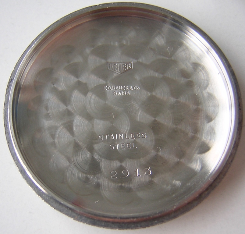

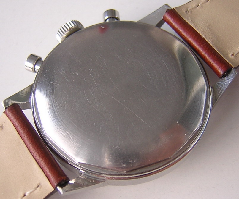

late 40s/early 50s waterproof with round pushers and a hex caseback. All marked on the inside case back with 2913, a serial 60xxx between the lugs and movements around 450xxx

Nonetheless I would seem logical to list these by the reference number stamped in the caseback.

1) Why do we not list these as 2913 (3reg) and 2923(dato)

3) How do you rate the dial on the Antiquorum sample?
4) Can anyone check if it sold and what it sold for?
